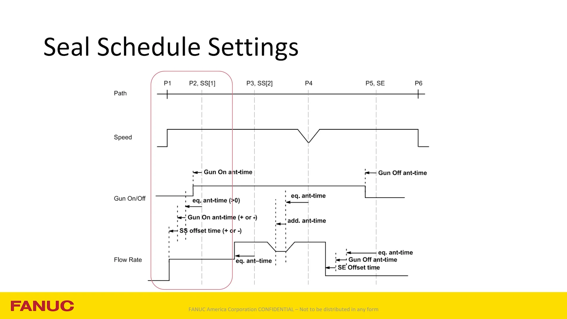

Throughout the series, we use the generic dispense process signal timing diagram from the SpotTool+ manual as a foundation for explaining the timing and flow control settings that influence dispensing performance. You'll learn how to optimize bead starts, maintain consistent flow throughout the dispense path, and create smooth, accurate bead endings while minimizing pressure fluctuations and process variability.
The series covers critical parameters including:
  • Pre Pressure for controlling initial material flow and improving bead starts
  • Gun On and Gun Off Anticipation Times for synchronizing valve operation with robot motion
  • Equipment Anticipation Time for compensating for metering system response delays
  • Seal Start and Seal End Offset Times for fine-tuning bead formation and transitions
  • Flow Rate Settings for controlling bead size and material delivery
  • Additional Anticipation Time, Correction Factor, and Correction Bias for improved accuracy during speed changes, corners, and complex path geometries
  • The impact of TCP height and dispensing conditions on overall bead quality
