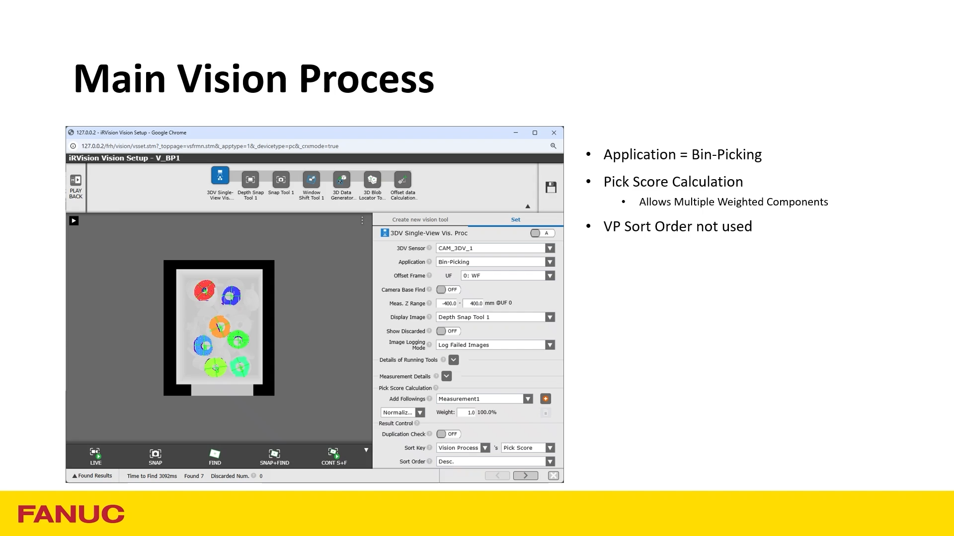

We begin by exploring the Vision Setup page, where all bin picking configurations are centralized. You’ll learn how to create a vision process tailored for bin picking, configure interference avoidance components, and tie everything together using the Parts List Manager. We’ll also discuss how to program a Teach Pendant (TP) program to execute the process seamlessly.
One of the highlights of this session is understanding how to manage dynamic bins. We’ll show you how to use tools like window shift and secondary vision processes to track bin movement and maintain accuracy. You’ll also discover how to configure pick scores, set reference positions, and optimize conditions for pick and approach flexibility.

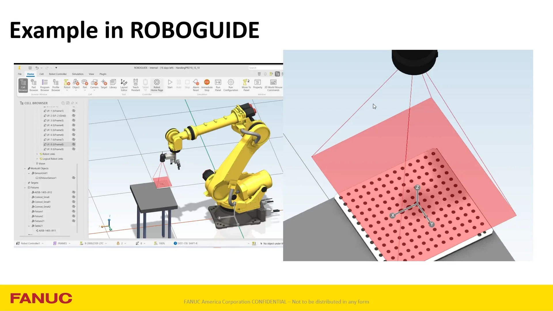

To make this practical, we’ll dive into the IA system object, where you define bin dimensions, add avoidance zones, and leverage 4D graphics for visualization and debugging. We’ll also touch on IA Robot setup, UTool configuration, and strategies for handling interference during pick operations.
