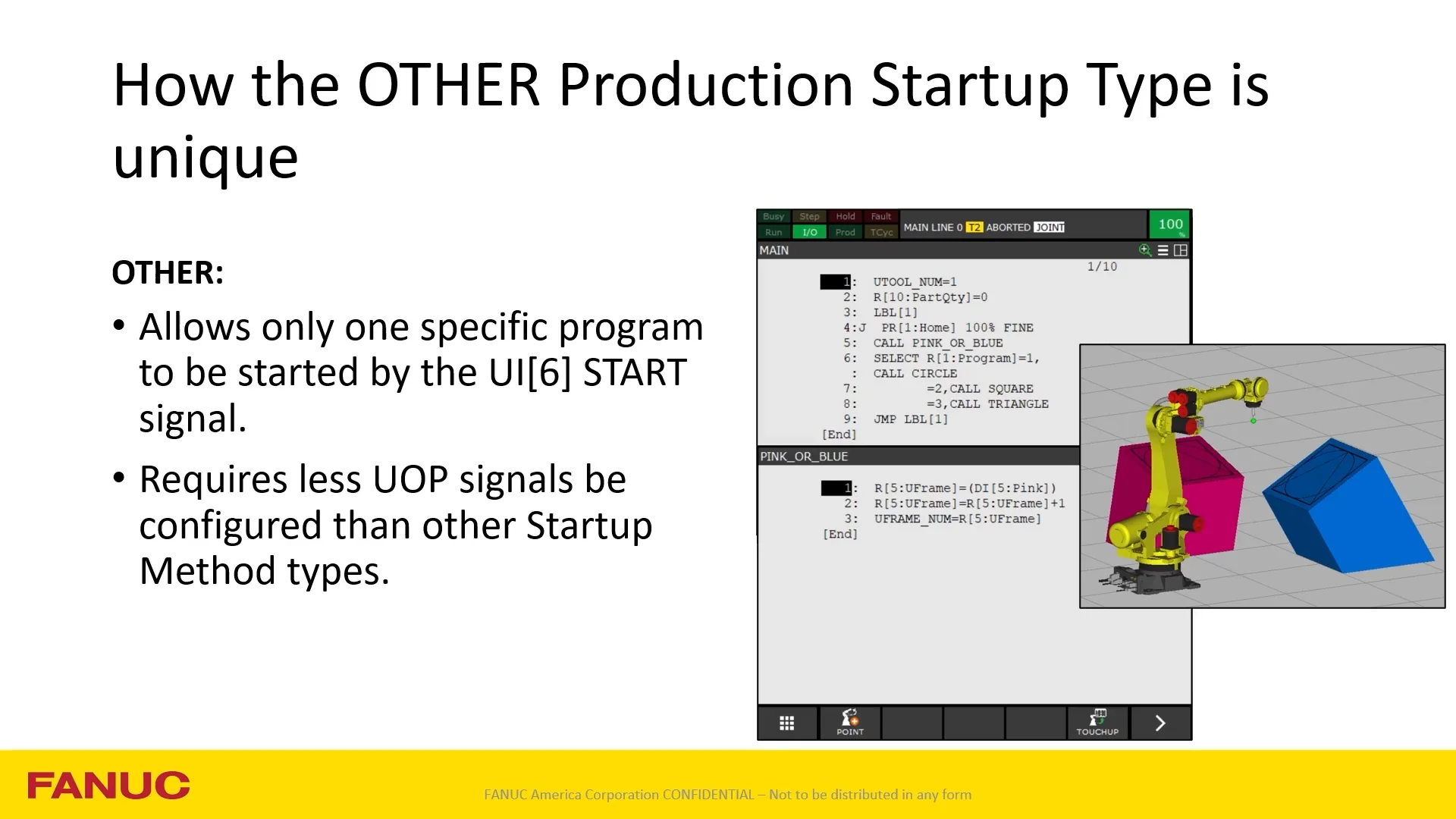

This three-part series provides a practical guide to implementing remote robot start functionality using User Operator Panel Inputs and Outputs (UOP I/O) on FANUC robots. Whether you are connecting a robot to a PLC, HMI, or another controlling device, understanding remote operation is essential for integrating robots into automated production systems and improving operator accessibility.
The series begins by introducing the OTHER Production Startup Method on the R-30iB Plus controller, explaining how remote control is achieved through UOP signals and how to configure a robot to run a designated MAIN program. From there, the series expands into the complete implementation process, including UOP I/O configuration, required System Configuration settings, and the procedures used to operate the robot remotely in AUTO mode.

- The OTHER Production Startup Method and its role in remote operation
- UOP Input and Output signal functions and requirements
- Configuration of UOP I/O for communication with PLCs and HMIs
- System Configuration settings for Remote Mode operation
- Enable UI Signals
- Remote/Local configuration
- CSTOPI for ABORT
- START for CONTINUE ONLY
- Running programs remotely using UOP signals
