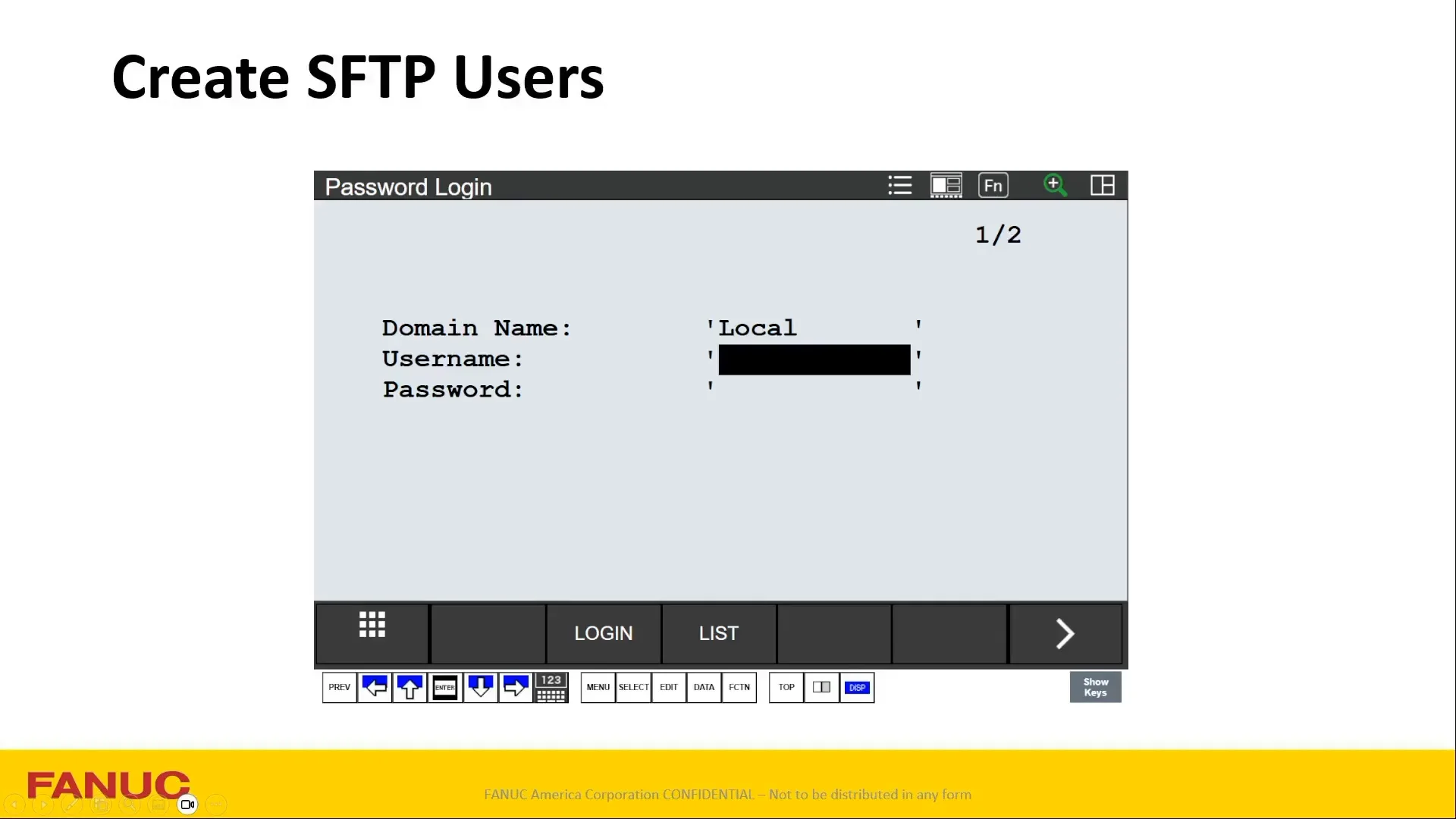

This three-part course provides a practical guide to configuring and using Secure File Transfer Protocol (SFTP) on FANUC R-50iA controllers. You'll learn how to establish secure file transfer connections, manage user access, navigate controller file systems, and implement enhanced security through public key authentication.
Part 1: SFTP Server Setup and Password Authentication
Begin by configuring the SFTP server on the controller and verifying all required prerequisites, including software version, licensing, and network connectivity. You'll create and test local user accounts, understand access level requirements, and establish secure connections using OpenSSH and WinSCP.
