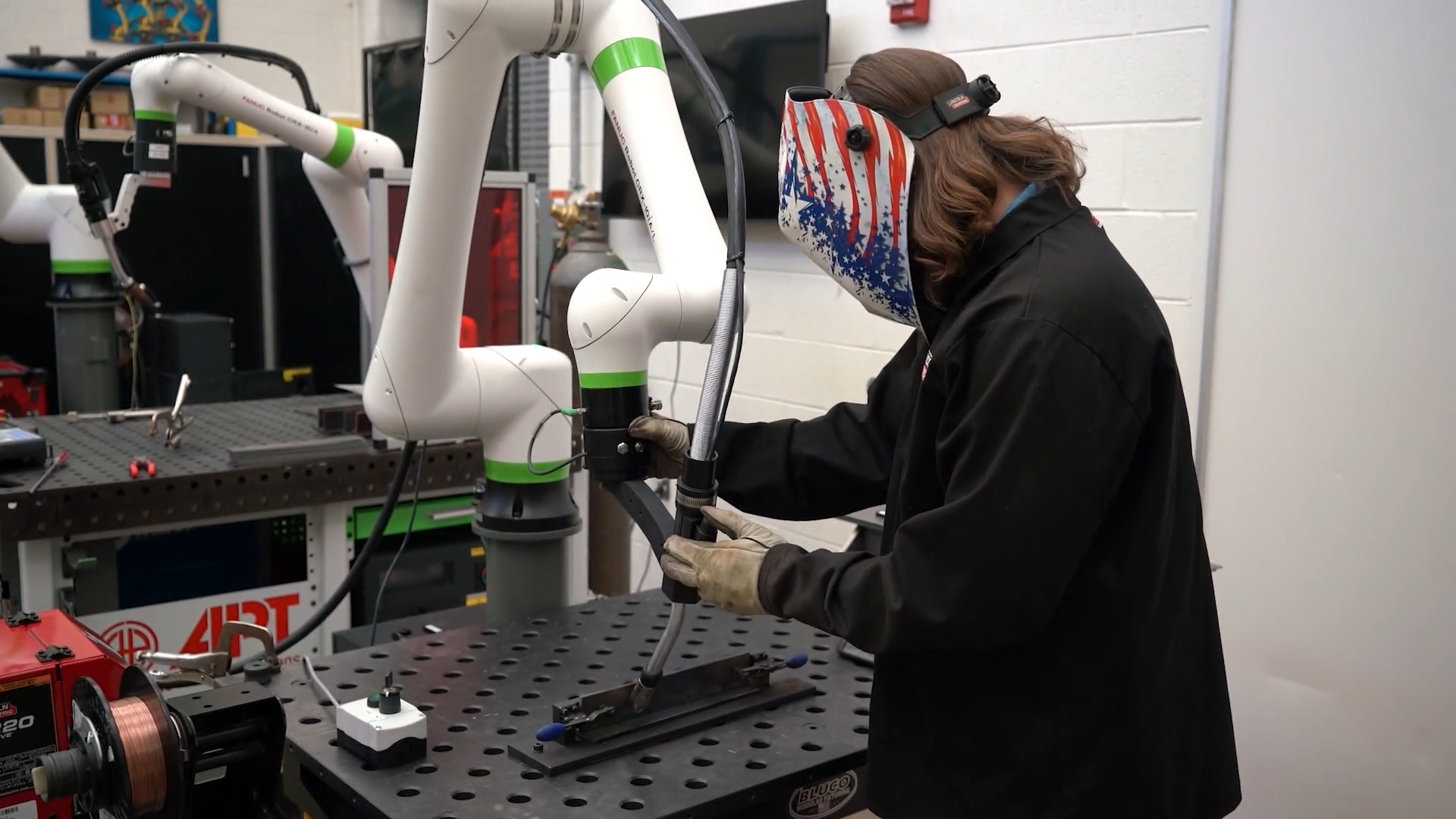

In this Tech Short, we will walk through the process of creating a manual tack welding program using FANUC robot wrist buttons. The focus is on giving you a practical, repeatable method for enabling quick tack weld execution directly from the robot, whether you are programming or operating on the floor. We will cover the full workflow from building a no motion program to configuring logic and tying everything together with wrist button inputs, so you can streamline your welding setup and reduce unnecessary complexity.
We begin by creating a dedicated tack program that operates without motion. From there, we will layer in the essential logic that allows the robot to manage weld behavior safely and consistently. This includes setting override values, triggering arc start and weld end functions, and ensuring proper conditions are in place to avoid common welding errors. As we move forward, we will also walk through how to configure wrist buttons so that executing a tack weld becomes as simple as pressing a button on the robot.
By the end, we will connect everything together during execution, showing how the program responds to operator input and maintains control during the welding cycle. This approach allows for greater flexibility and control when performing manual tacking operations.
