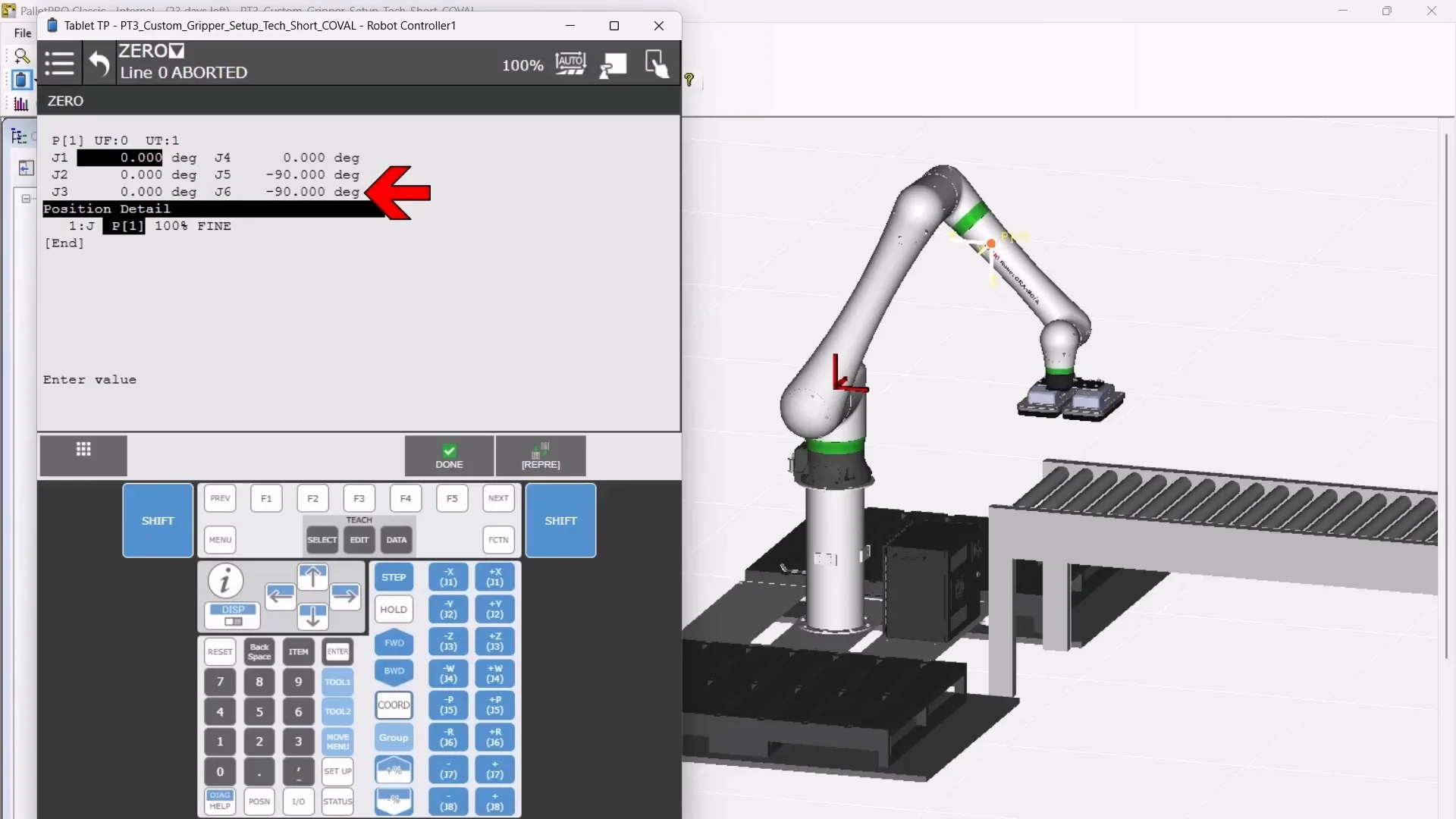

This video offers a comprehensive guide to the FANUC Payload Checker, a crucial tool for optimizing robot performance and preventing damage. It begins by explaining how to locate and interpret your specific robot's payload specifications. You'll then get a thorough overview of the FANUC Payload Checker's interface and functionality, with step-by-step instructions on its use. The video also addresses scenarios involving payloads mounted on various robot parts beyond the wrist. It provides clear guidance on what to do if your desired payload exceeds your chosen robot's limits, offering solutions to ensure safe and efficient operation.
